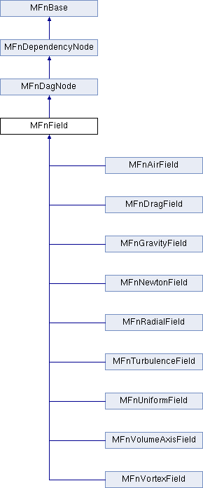

| virtual MFn::Type | type () const |
| | Function set type. More...
| virtual | ~MFnField () |
| | Destructor. More...
| MFnField () |
| | Default constructor.
| | MFnField (MObject &object, MStatus *ReturnStatus=NULL) |
| | Constructor. More...
| | MFnField (const MDagPath &object, MStatus *ret=NULL) |
| MStatus | getForceAtPoint (const MPointArray &point, const MVectorArray &velocity, const MDoubleArray &mass, MVectorArray &force, double deltaTime=1.0/24.0) |
| | Compute the force of a field on an array of points, given their position, velocity, and mass. More...
| MStatus | getForceAtPoint (const MVectorArray &point, const MVectorArray &velocity, const MDoubleArray &mass, MVectorArray &force, double deltaTime=1.0/24.0) |
| double | magnitude (MStatus *ReturnStatus=NULL) const |
| | Returns the strength of the field. More...
| MStatus | setMagnitude (double mag) |
| | Sets the strength of the field. More...
| double | attenuation (MStatus *ReturnStatus=NULL) const |
| | Returns the rate of change where the strength of the field changes as the distance between the field and the affected object increases. More...
| MStatus | setAttenuation (double atten) |
| | Sets the rate of change where the strength of the field changes as the distance between the field and the affected object increases. More...
| double | maxDistance (MStatus *ReturnStatus=NULL) const |
| | Returns the maximum distance from the field at which the force of the field is exerted. More...
| MStatus | setMaxDistance (double maxDist) |
| | Sets the maximum distance from the field at which the force of the field is exerted. More...
| bool | perVertex (MStatus *ReturnStatus=NULL) const |
| | Returns true if the field exerts its force on each individual point (cv, particle, vertex) equally. More...
| MStatus | setPerVertex (bool enable) |
| | Enables the field to exert its force on each individual point (cv, particle, vertex) equally. More...
| bool | useMaxDistance (MStatus *ReturnStatus=NULL) const |
| | Returns true if the field will use the maximum distance setting to determine the area of influence. More...
| MStatus | setUseMaxDistance (bool enable) |
| | Enables the field to use the maximum distance setting to determine the area of influence. More...
| double | falloffCurve (const double param, MStatus *ReturnStatus=NULL) |
| | Returns falloff given the param in [0,1]. More...
| bool | isFalloffCurveConstantOne (MStatus *ReturnStatus=NULL) |
| | Returns true if falloffCurve is a constant one (default) or false if not. More...
| | MFnField (const MObject &object, MStatus *ret=NULL) |
