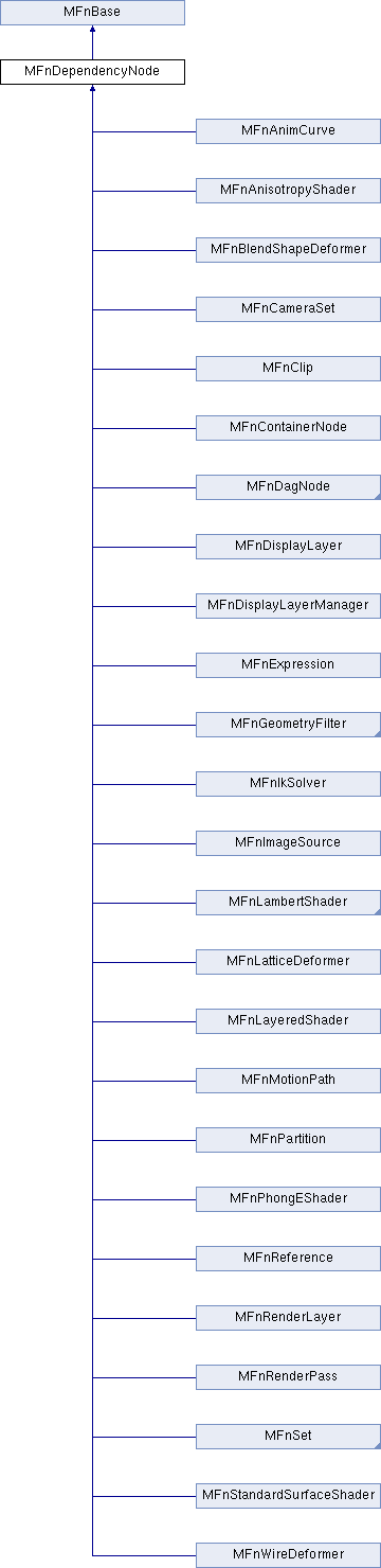

Inheritance diagram for MFnDependencyNode:Public Types | |

Function set type.
Return the class type : MFn::kDependencyNode.
Reimplemented from MFnBase.
Reimplemented in MFnAnimCurve, MFnSubd, MFnMesh, MFnTransform, MFnNurbsSurface, MFnNurbsCurve, MFnAssembly, MFnClip, MFnCharacter, MFnBlendShapeDeformer, MFnParticleSystem, MFnDagNode, MFnIkJoint, MFnLatticeDeformer, MFnWeightGeometryFilter, MFnSet, MFnMotionPath, MFnLattice, MFnRotateManip, MFnScaleManip, MFnDisplayLayerManager, MFnSkinCluster, MFnDisplayLayer, MFnCameraSet, MFnFluid, MFnFreePointTriadManip, MFnGeometryFilter, MFnImageSource, MFnPartition, MFnReference, MFnSpotLight, MFnWireDeformer, MFnLayeredShader, MFnPhongEShader, MFnToggleManip, MFnAnisotropyShader, MFnCamera, MFnContainerNode, MFnExpression, MFnHikEffector, MFnLambertShader, MFnReflectShader, MFnDirectionManip, MFnDistanceManip, MFnIkEffector, MFnIkSolver, MFnManip3D, MFnRenderPass, MFnStateManip, MFnCircleSweepManip, MFnCurveSegmentManip, MFnDragField, MFnLight, MFnNewtonField, MFnNonAmbientLight, MFnNonExtendedLight, MFnPointOnCurveManip, MFnPointOnSurfaceManip, MFnRadialField, MFnRenderLayer, MFnStandardSurfaceShader, MFnVortexField, MFnAmbientLight, MFnAreaLight, MFnDirectionalLight, MFnDiscManip, MFnGravityField, MFnPfxGeometry, MFnPointLight, MFnTurbulenceField, MFnUniformField, MFnVolumeAxisField, MFnVolumeLight, MFnAirField, MFnBlinnShader, MFnField, MFnIkHandle, MFnPhongShader, and MFnInstancer.
