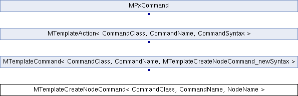

Inheritance diagram for MTemplateCreateNodeCommand< CommandClass, CommandName, NodeName >:Public Member Functions | |

Template class for undoable commands to create/delete a node.
Helper template class which make it easier to write commands to create/delete a node.
The command is tied into an MDGModifier to create a node with undo support.
