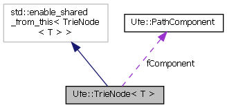

Public Types | |
| typedef std::shared_ptr< TrieNode > | Ptr |
Public Member Functions | |
| TrieNode (const PathComponent &component) | |
| TrieNode () | |
| Ptr | parent () const |
| void | add (const Ptr &child) |
| void | remove (const Ptr &child) |
| bool | contains (const PathComponent &child) const |
| Ptr | operator[] (const PathComponent &child) const |
| std::size_t | size () const |
| std::size_t | treeSize () const |
| bool | empty () const |
| PathComponent | component () const |
| void | rename (const PathComponent &component) |
| void | move (const PathComponent &component, const Ptr &newParent) |
| void | setData (const T &data) |
| const T & | data () const |
| bool | hasData () const |
| int | closestCommonAncestor (int depth) const |
Private Types | |
| typedef std::unordered_map< PathComponent, Ptr > | Children |
| typedef std::weak_ptr< TrieNode > | ParentPtr |
Private Member Functions | |
| void | clear () |
| void | clearData () |
| void | setParent (Ptr parent) |
Private Attributes | |
| PathComponent | fComponent |
| ParentPtr | fParent |
| Children | fChildren |
| bool | fHasData |
| T | fData |
Friends | |
| class | Trie< T > |

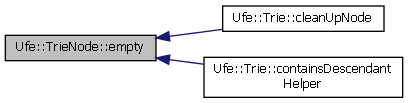

| bool Ufe::TrieNode< T >::empty | ( | ) | const |
Definition at line 131 of file trie.imp.h.
Referenced by Ufe::Trie< T >::cleanUpNode(), and Ufe::Trie< T >::containsDescendantHelper().

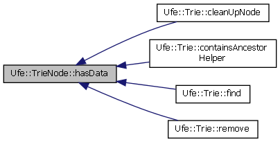

| bool Ufe::TrieNode< T >::hasData | ( | ) | const |
Definition at line 188 of file trie.imp.h.
Referenced by Ufe::Trie< T >::cleanUpNode(), Ufe::Trie< T >::containsAncestorHelper(), Ufe::Trie< T >::find(), and Ufe::Trie< T >::remove().
