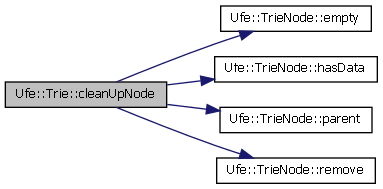

| TrieNode< T >::Ptr | createNode (const Path &path) |
| void | cleanUpNode (const typename TrieNode< T >::Ptr &node) |

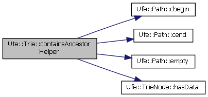

| template<bool INCLUDE_DESCENDANT> | |
| bool | containsAncestorHelper (const Path &path) const |

private |
Definition at line 409 of file trie.imp.h.
References Ufe::TrieNode< T >::empty(), Ufe::TrieNode< T >::hasData(), Ufe::TrieNode< T >::parent(), and Ufe::TrieNode< T >::remove().

private |
Definition at line 331 of file trie.imp.h.
References Ufe::Path::cbegin(), Ufe::Path::cend(), Ufe::Path::empty(), and Ufe::TrieNode< T >::hasData().
