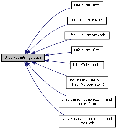

| Path Ufe::PathString::path | ( | const std::string & | pathString | ) |
| pathString | A string with path segments separated by the path segment separator. |
| EmptyPathSegment | If the path segment is an empty string, or a degenerate single path component separator (e.g. "/a/b,|", where "|" is a degenerate path segment). |
| InvalidPathComponentSeparator | If the leading character or the character following the path segment separator is not a path component separator (e.g. "/a/b,foo", where "f" is not a path component separator). |
| InvalidPath | If multiple runtimes register the same path component separator, each will be asked to create a scene item for the argument path string. If none succeeds, InvalidPath is thrown. |
Referenced by Ufe::Trie< T >::add(), Ufe::Trie< T >::contains(), Ufe::Trie< T >::createNode(), Ufe::Trie< T >::find(), Ufe::Trie< T >::node(), std::hash< Ufe_v3 ::Path >::operator()(), Ufe::BaseUndoableCommand::sceneItem(), and Ufe::BaseUndoableCommand::setPath().
