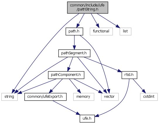

Universal Front End is a DCC-agnostic component that will allow a DCC to browse and edit data in multiple data models
Go to the source code of this file.
Namespaces | |
| Ufe | |
| PathString | |
| Ufe::PathString | |
Typedefs | |
| typedef std::function< Path(const Path::Segments &)> | Ufe::PathString::CreatePathFn |
| typedef std::function< Path(const std::string &)> | Ufe::PathString::CreateSingleSegmentPathFn |
| typedef std::function< std::string(const Path &)> | Ufe::PathString::StringFn |
Functions | |
| Path | Ufe::PathString::path (const std::string &pathString) |
| std::string | Ufe::PathString::string (const Path &path) |
| std::string | Ufe::PathString::pathSegmentSeparator () |
| void | Ufe::PathString::setPathSegmentSeparator (const std::string &separator) |
| CreatePathFn | Ufe::PathString::createPathFn () |
| void | Ufe::PathString::setCreatePathFn (const CreatePathFn &fn) |
| CreateSingleSegmentPathFn | Ufe::PathString::createSingleSegmentPathFn (const Rtid &rtId) |
| void | Ufe::PathString::setCreateSingleSegmentPathFn (const Rtid &rtId, const CreateSingleSegmentPathFn &fn) |
| StringFn | Ufe::PathString::stringFn () |
| void | Ufe::PathString::setStringFn (const StringFn &fn) |
| void | Ufe::PathString::registerPathComponentSeparator (const Rtid &rtId, char sep) |
| void | Ufe::PathString::unregisterPathComponentSeparator (const Rtid &rtId, char sep) |
| std::list< Ufe::Rtid > | Ufe::PathString::pathComponentSeparatorRunTimeIds (char sep) |
