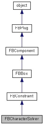

Constraint class. More...

Constraint class.
