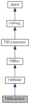

Null object class. More...
Public Member Functions | |
FBModelNull (str pName) | |
Constructor. More... | |
FBModel (str pName) | |

Null object class.
FBModelNull | ( | str | pName | ) |
Constructor.
pName | Name of null. |
float Size |
Read Write Property: Size (not related to scaling).
