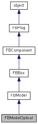

FBModelOptical Class Reference
Optical model class. More...
Inheritance diagram for FBModelOptical:
