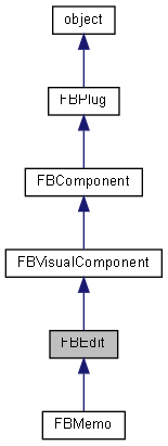

Text edit box. More...
Public Member Functions | |
| FBEdit () | |
| Constructor. More... | |
