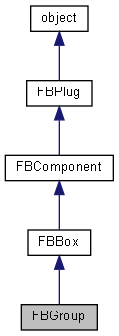

Objects Grouping class. More...
This class is an interface to manipulate object's grouping in the scene.
| FBGroup Clone | ( | ) |
Clone the group.
This will duplicated the current group.
| bool Contains | ( | FBComponent | pComponent | ) |
Contains.
| pComponent | Component to verify if it is in the Group |
| FBDelete | ( | ) |
Virtual FBDelete function.
| Select | ( | bool | pSelect | ) |
Select.
| pSelect | If true, group contents will be selected. |
| FBListComponent Items |
List: Items in the group.
| bool Pickable |
Read Write Property: Controls if objects in the group are pickable.
| bool Show |
Read Write Property: Controls if objects in the group are displayed.
| bool Transformable |
Read Write Property: Controls if objects in the group are transformable.
