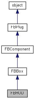

Heads Up display. More...
Public Member Functions | |
| FBHUD (str pName) | |
| Constructor. More... | |
| FBHUDElement | CreateCustomElement (str pHUDElementClassName, str pName) |
| Creates a custom HUD Element. More... | |
| FBHUDElement | CreateElement (EStockElement pType, str pName) |
| Creates a stock HUD Element. More... | |

Heads Up display.
Display scene related information to the screen. This information will also be present in the rendered frames when creating AVIs or QuickTime files.
See samples: BloopSlate.py, HUDElements.py, HUDTextElement.py, RecordLight.py, Timeline.py, HUD.py.
