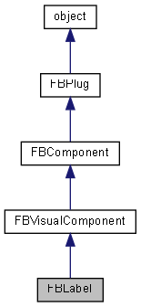

Text label. More...
Public Member Functions | |
| FBLabel () | |
| Constructor. More... | |
