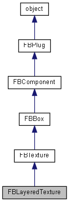

LayeredTexture class.
This class is used to encapsulate list of textures. User could subclass this class to support customized blending & compostion modes. See /OpenRealitySDK/Samples/miscellaneous/texture_template/ for example.
