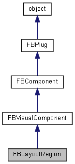

Layout region. More...

Layout region.
| FBLayoutRegion | ( | ) |
Constructor.
