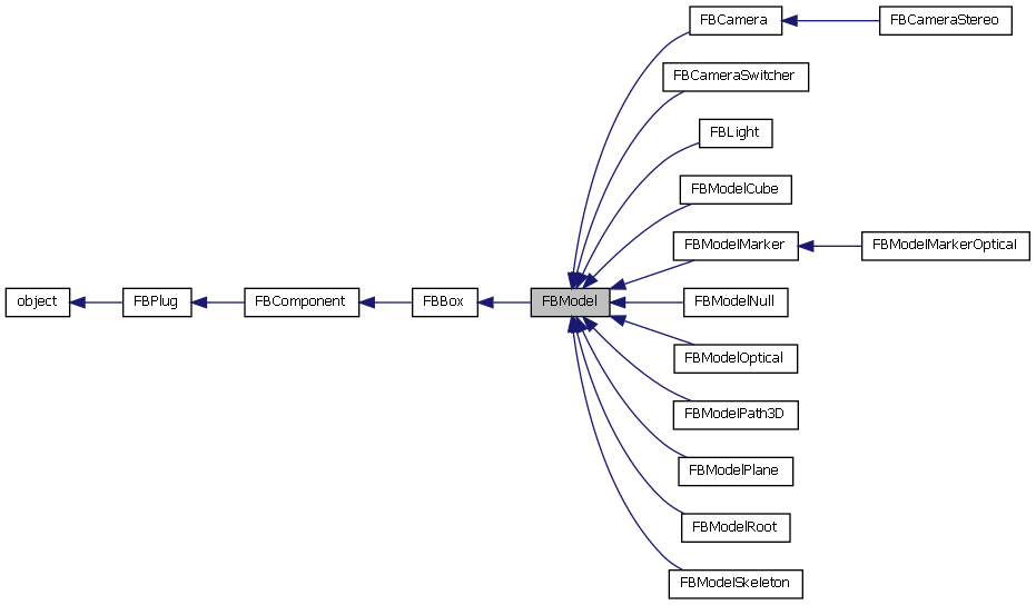

FBModel Class Reference
Model class. More...

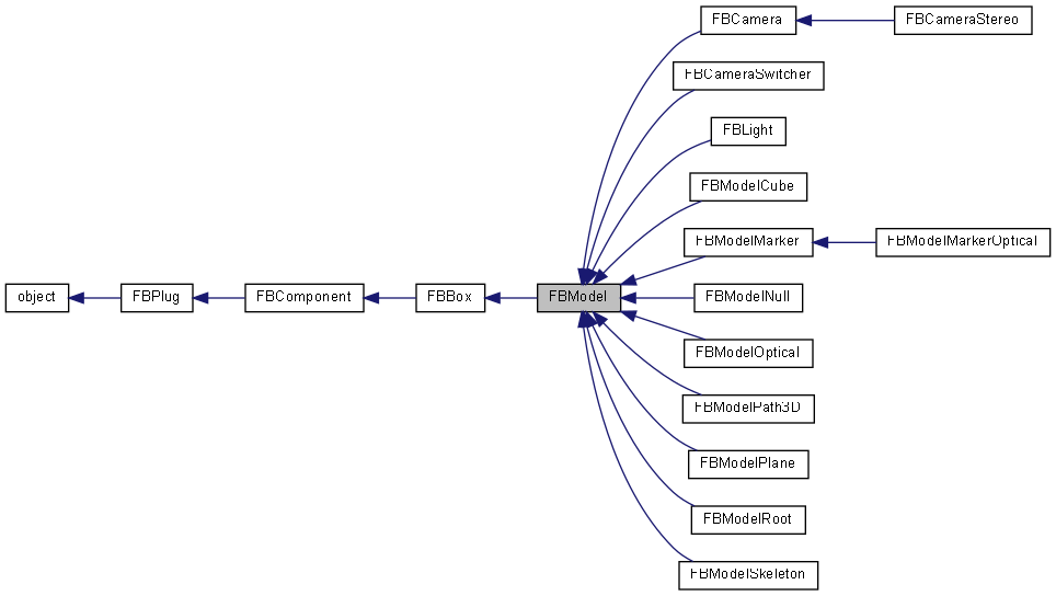

Inheritance diagram for FBModel:
