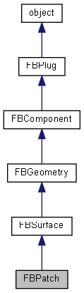

Patch class. More...
Public Member Functions | |
| FBPatch (str pName) | |
| Constructor. More... | |
| ControlPointsBegin () | |
| Begin control points edition. More... | |
| ControlPointsEnd () | |
| End control points edition. More... | |
| SurfaceBegin () | |
| Begin Patch definition. More... | |
| SurfaceEditBegin () | |
| Begin patch surface edit. More... | |
| SurfaceEditEnd () | |
| End patch surface edit. More... | |
| SurfaceEnd () | |
| End Patch definition. More... | |
Public Member Functions inherited from FBSurface | |

Public Member Functions inherited from FBGeometry | |

Public Member Functions inherited from FBComponent | |
