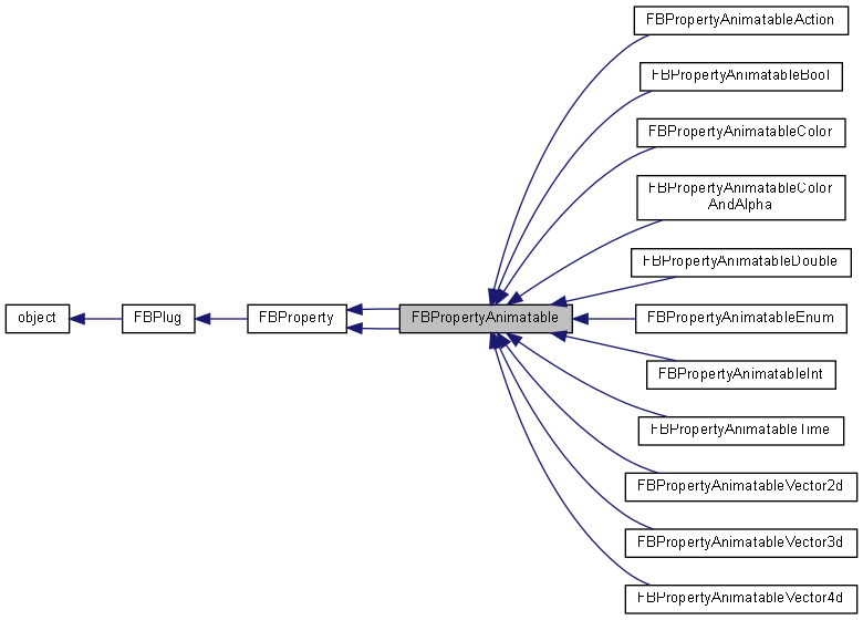

Animatable property base class. More...
Inheritance diagram for FBPropertyAnimatable:
