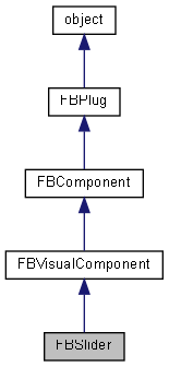

Slider. More...
Public Member Functions | |
| FBSlider () | |
| Constructor. More... | |
