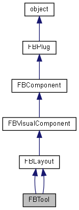

Tool class. More...
Public Member Functions | |
| FBTool (str pName=None) | |
| Constructor. More... | |
| FBTool (str pName, bool pRegisterTool) | |
| Constructor used when creating tools not in the Tools menu of MotionBuilder. More... | |
| FBToolPossibleDockPosition | GetPossibleDockPosition () |
| Get the possible docking position for the tool (concatenated). More... | |
| SetPossibleDockPosition (FBToolPossibleDockPosition pFlags) | |
| Set the possible docking position for the tool. More... | |
Public Member Functions inherited from FBLayout | |

Public Member Functions inherited from FBVisualComponent | |

Public Member Functions inherited from FBComponent | |
