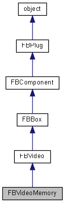

FBVideoMemory allow external media source (which can't be supported by MoBu natively)
User could create / update OGL texture (GL_TEXTURE_2D type) externally, and pass in GL texture object id to TextureOGLId property.See "Scripts/Samples/Video/VideoMemory.py" for usage example.
| FBVideoMemory | ( | str | pName | ) |
Constructor.
| pName | Name of video media. |
Set image size to allow MoBu preview texture with proper dimension / aspect.
| pW | Width of image. |
| pH | Height of image. |
| int TextureOGLId |
Read Write Property: OpenGL texture buffer object id (GL_TEXTURE_2D type).
