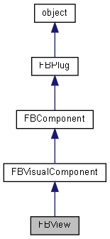

Generic view. More...

Public Member Functions inherited from FBVisualComponent | |

Public Member Functions inherited from FBComponent | |

Generic view.
