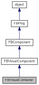

Used to create a container for a tool UI. More...
