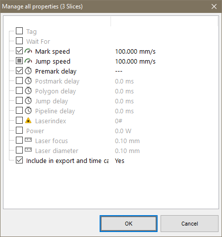

Managing multiple properties at once
  1. Right-click the slice stack
  2. Choose Add property > Manage all properties.
This opens a dialog which lists the available properties. Here you can not only modify them all at once, you can also disable them so that they don't override their defaults during export. The value remains saved in the FABBPROJECT file even when the respective property is disabled. Additionally, this dialog supports settings management where you can store and retrieve values and disabled/enabled states for the whole dialog at once.
To manage multiple stacks at once, select them all before choosing Add property > Manage all properties.
Example of inactive, active, and individually different overides of default values

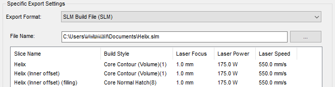

Setting slice properties during export
When exporting to certain formats (buildfiles for SLM, LSR, NSP, AI, or ILT), a section in the export dialog is available to adjust these. The export loads built-in defaults that you can modify here for this instance of exporting, and are not saved when you close the dialog.
Example: Slice properties set for export to SLM buildfile. (The parameter Build Style here is format-specific and only available in this export dialog.)
  1. Prepare slice stacks for contours, hatchings, support, and any others needed for your build.
  2. Select all stacks.
  3. From the main menu, choose Export > Export.
  4. Choose the desired output format.
  5. In Specific Export Settings, double-click the slice to modify.
  6. In the <format> Export Settings dialog, adjust the properties as required by your build.
  7. Click OK.
    The adjustment is now saved to the properties you modified.
  8. Click OK to export the printjob file with the modified properties.
