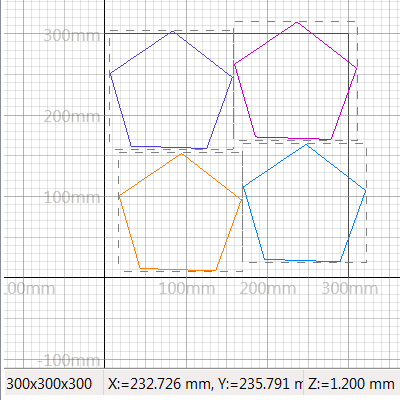

  2. Optionally, arrange the contours on the platform using the outboxes as a guide.
    Note: This is agnostic to the platform size where the respective parts originated and what target the target platform size is. The buildroom dimensions are only displayed as a guide. Unless adjusted in the slice export, the exported slice files are sized to the minimum necessary dimensions to enclose all present outboxes over the entire slicing height.

    The display shows labeled axes, outboxes as dashed lines, an auto-scaling grid, and the corresponding platform's outline in addition to the various slice contours. At the bottom you see the platform dimensions as well as the current mouse pointer coordinates and the z-height of the currently displayed slice.

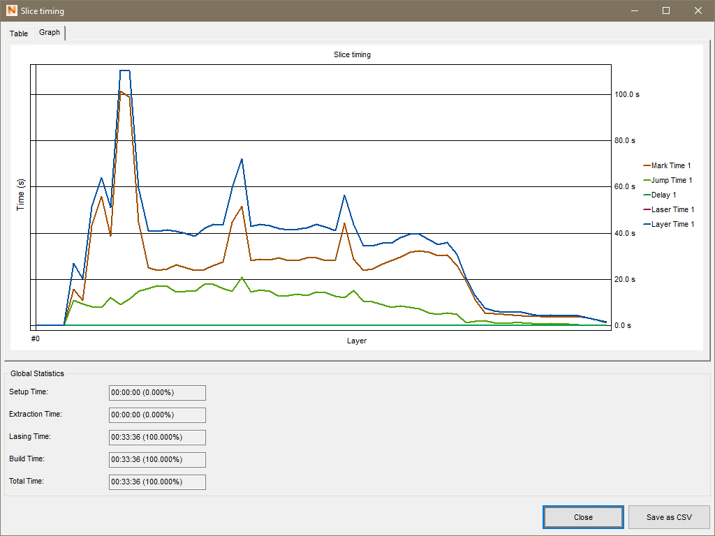

    Right-click the respective Slices section itself to access detailed slice time statistics in table and chart representation across the slices and to manage the default properties and their values for new slice stacks.
    Use the slice timing analysis to identify phases of high and low utilization. Hover the mouse pointer over items to highlight the associated curve, and click on items to toggle their visibility.
