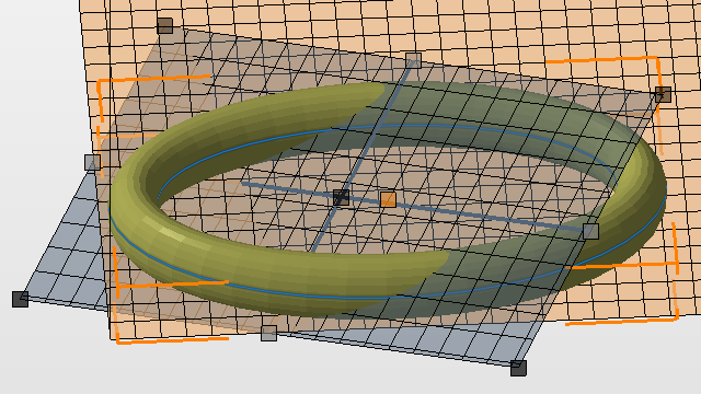

Optional: Adjust at what angle and how wide to cut
If the plane is already in the right position, you can proceed to cutting. If not, adjust the plane using any of these methods:
Rotation and size
- Optional: Using
left-click, drag the
corner points of the plane to rotate the plane about its normal axis. This adjusts the plane's rotation axis for the next step:
- Using
edge points to rotate the whole plane about the axis tangential to the edge point.
- Using
right-click, drag the
edge and corner points to resize the plane. Useful if you want to cut only a section of a part while leaving the rest alone.
The cutting plane cuts at any angle you require.

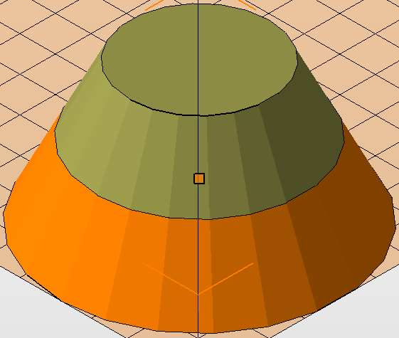

Perform the cut
In the context view, click
Cut.
This cone frustum has been cut in half.
