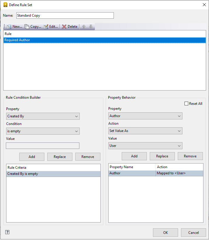

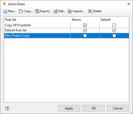

A rule set is a collection of property rules that determine file property behavior during a copy operation.
During a copy operation, only one rule set can be applied to the selected data set. For this reason, a rule set can contain a number of rules that determine the settings of multiple file types based on extension, properties, or use.
A rule set contains one or more rules. Each rule is defined by one or more conditions that, if met, assigns certain file properties and behavior settings to the destination files.
Rules are created, edited, and deleted on the Define Rule Set dialog.
Refer to the following table for information about the Define Rule Set interface.

Rule Condition Builder |
Property drop-down menu |
The property for which you want to create the condition criteria. |
Condition drop-down menu |
The condition the property must meet for the rule to assign the specified property behavior to the destination file.
Condition options include: Important: If a rule has more than one condition, all conditions must be met for the specified property behavior to be applied.
Value |
If the condition requires a particular value, the value is defined here. For example, you can specify that drawing files be handled differently during a copy operation. To do so you would:
Add |
Click Add to Add the condition to the rule. |
Replace |
Select an existing condition and update the property, condition, or value fields. Click Replace to replace the condition's criteria with the new criteria you have defined. |
Remove |
Select an existing condition and click Remove to delete it from the rule. |
Rule Criteria List |
Lists the conditions and criteria that have been created for the current rule. The order in which the conditions are listed is the order in which the file must meet the criteria to trigger the specified property behavior. |
Property Behavior Note: User-defined properties that are not mapped inside the vault will transfer during Copy Design.
Reset All check box |
Resets the source file behaviors on the destination file. The destination file has the same properties and behavior settings as a new file that has been added to Vault. |
The property for which you want to property behavior criteria. |
Action drop-down menu |
The action that you want applied to the selected property on the destination file. Action options are:
Value drop-down menu |
The value that you want to use for the selected property in the destination file.
Available values are: |
Add |
Click Add to add the defined property behavior to the rule. |
Replace |
Select an existing property behavior and update the property, action, or value fields. Click Replace to replace the property behavior with the new criteria you have defined. |
Remove |
Select an existing property behavior and click Remove to delete it from the rule. |
Property Name and Action lists |
Lists the property that is impacted when the condition is met and the action that is taken. If a value is assigned, the action includes the value detail. |
