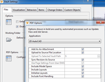

Configurable PDF Settings
Vault 2018 automatically renders PDF formats from 2D design files using the same settings as the authoring CAD systems. It supports the DWG and IDW 2D design files from AutoCAD and Inventor drawing files.
For more information, see Configure PDF Publishing Options.

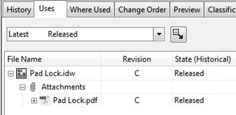

Automatic PDF Attachment
In Vault 2018, PDF files created for document control are automatically attached to their accompanying design file. As a result, designers see all attached PDF files in the Vault Client's Uses tab.

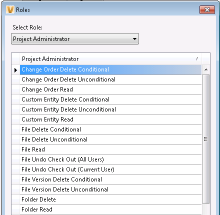

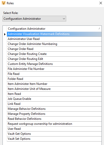

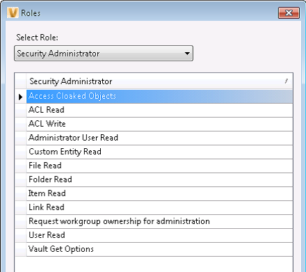

Vault 2018 introduces new Administrator roles that allow team members to manage aspects of Vault such as configuration or security settings without being a full administrator.

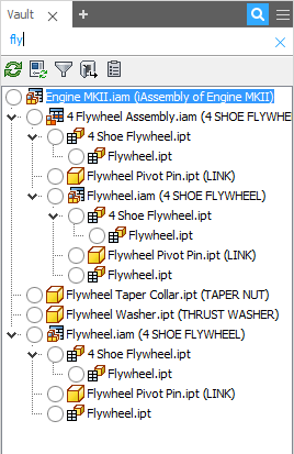

Search in Vault Browser
The Vault 2018 Add-in for Inventor provides a new Vault browser search, including multiple keyword search, to help users identify and select components within the Vault component tree. After adding new properties to the browser display, you may also search for components by property and locate items more easily within the component structure of large assemblies.
For more information, see The Vault Browser in Autodesk Inventor.

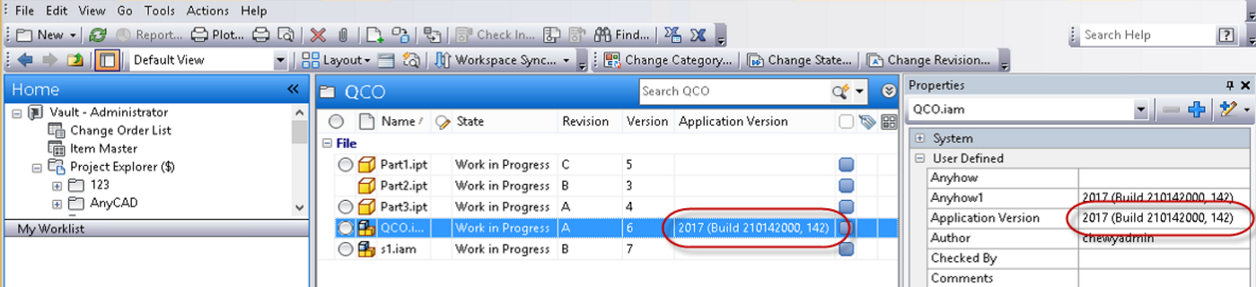

New Application Version File Property
A new Application Version property for Inventor files shows the last time the file was saved and the version of Inventor it was saved in.
The application version property is currently only for Inventor Files.
See Add or Remove User-Defined Properties for more information. Also see the Customize Columns section in Custom Grid Options.

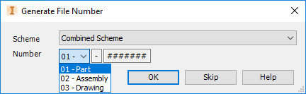

Numbering Scheme Descriptions Now Display When You Save a New File
When you define a numbering scheme you can create a description for a pre-defined list. These descriptions for numbering schemes now display when you create a new file in Inventor or AutoCAD and save it.

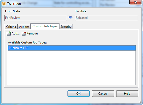

Custom Job Types
Vault administrators may now assign custom jobs to lifecycle transitions directly within the Vault Settings dialog. When defining new or existing lifecycles, Vault administrators may edit the lifecycle state transition and use the new Custom Job Types tab to specify a custom job.
The work to write and test the custom job routine remains, just as in previous versions of Vault, but the administrative steps required to include the action as part of a lifecycle are now much easier.
To learn more about how to create a custom job, see Create a Custom Job.
