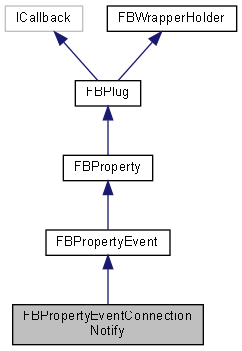

PropertyEvent: Global ConnectionNotify event. More...
#include <fbproperties.h>
Definition at line 588 of file fbproperties.h.
virtual |
Add/Remove a callback.
| pOwner | Callback owner. |
| pHandler | Callback handler. |
Reimplemented from FBPropertyEvent.
