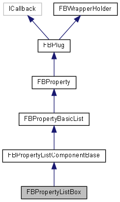

List: Box informations for constraint relation.
Definition at line 368 of file fbconstraint.h.
