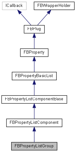

List: Group More...
#include <fbgroup.h>
Public Member Functions | |
| FBGroup * | operator[] (int pIndex) |
| Get the group at pIndex. More... | |

| FBGroup* operator[] | ( | int | pIndex | ) |
| pIndex | Index of group to get. |
