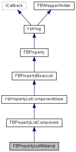

PropertyList: Material More...
#include <fbmaterial.h>
Public Member Functions | |
| FBMaterial * | operator[] (int pIndex) |
| Get the material at a specific index. More... | |
Public Member Functions inherited from FBPropertyListComponent | |
| virtual FBComponent * | GetAt (int pIndex) |
| Get the Component at pIndex. More... | |
Public Member Functions inherited from FBPropertyListComponentBase | |
| FBPropertyListComponentBase () | |
| Constructor. More... | |
| virtual int | Add (FBComponent *pItem) |
| Add a component to the list. More... | |
| virtual void | RemoveAt (int pIndex) override |
| Remove the component at pIndex from list. More... | |
| FBComponent * | operator[] (int pIndex) |
| virtual int | GetCount () override |
| Get the Component count. More... | |
| virtual int | Find (FBComponent *pItem) |
| Locate a property in the list. More... | |
| virtual int | Remove (FBComponent *pItem) |
| Remove pItem from the list. More... | |
| void | SetClassId (int pClassId) |
| int | GetClassId () |
| void | SetListOfParents (bool pListOfParents) |
| bool | GetIsListOfParents () |
| virtual FBPropertyType | GetPropertyType () override |
| Get the property's type. More... | |
Public Member Functions inherited from FBPropertyBasicList | |
| FBPropertyBasicList () | |
| FBPropertyBasicList (HIObject pParent, const char *pName) | |
| FBProperty * | Init (void *pParent, const char *pName) |
| Initialization function. More... | |
| void | RemoveAll () |
| Remove all properties from the list. More... | |
| virtual bool | IsList () |
| Is this a list? More... | |
Public Member Functions inherited from FBProperty | |
| FBProperty () | |
| void | SetEnable (bool pValue) |
| Set property enable status. More... | |
| const char * | GetName () |
| Get the property's name. More... | |
| void | SetName (const char *pName) |
| Set the property's name. More... | |
| const char * | GetPropertyTypeName () |
| Get the property's type name. More... | |
| virtual KDataType * | GetDataType () |
| Get the property datatype pointer. More... | |
| virtual void | SetData (void *pData) |
| Set the value of the property, passing the type as an argument. More... | |
| virtual void | GetData (void *pData, int pSize, FBEvaluateInfo *pEvalInfo=NULL) const |
| Get the value of a property. More... | |
| int | AsInt () |
| Get the property as an integer. More... | |
| bool | SetInt (int pInt) |
| Set the property from an integer. More... | |
| virtual const char * | AsString (FBDataAsStringFlag pFlag=kFBDataAsStringUI) |
| Get the property value as a string. More... | |
| virtual bool | SetString (const char *pString) |
| Set the property value from a string. More... | |
| const char * | OriValueAsString () |
| Get the property original value (before any modification) as string. More... | |
| bool | IsAnimated () const |
| Get the property animated flag status. More... | |
| bool | OriIsAnimated () const |
| Get the property original animated flag status (before any modification) More... | |
| virtual bool | IsAnimatable () |
| bool | IsInternal () const |
| bool | IsUserProperty () |
| bool | IsTextureConnectableProperty () |
| bool | IsReferenceProperty () |
| bool | IsMinClamp () |
| Indicate if minimum value clamping will be applied on user input value. More... | |
| bool | IsMaxClamp () |
| Indicate if maximum value clamping will be applied on user input value. More... | |
| bool | IsTemporaryProperty () |
| Indicate if a property was created on retrieve because it didn't exist. More... | |
| bool | AcceptTemporaryProperty (const char *pEnumList[]=NULL, fbExternalGetSetHandler pGet=NULL, fbExternalGetSetHandler pSet=NULL) |
| Accept a temporary property as a dynamic property. More... | |
| bool | IsObjectList () |
| Indicate if is an instance of FBPropertyListObject. More... | |
| virtual bool | IsReadOnly () |
| Is property read-only? More... | |
| virtual const char * | EnumList (int pIndex) |
| Return the string of an enum value. More... | |
| FBStringList * | GetEnumStringList (bool pCreateIt=false) |
| String list for enum properties. More... | |
| void | NotifyEnumStringListChanged () |
| Notify system that the enum list was modified. More... | |
| void | ModifyPropertyFlag (FBPropertyFlag pFlag, bool pValue) |
| ModifyPropertyFlag. More... | |
| FBPropertyFlag | GetPropertyFlags () |
| GetPropertyFlags. More... | |
| bool | GetPropertyFlag (FBPropertyFlag pFlag) |
| GetPropertyFlag. More... | |
| void | SetMinMax (double pMin, double pMax, bool pForceMinClamp=false, bool pForceMaxClamp=false) |
| SetMinMax. More... | |
| void | SetMin (double pMin, bool pForceMinClamp=false) |
| SetMin. More... | |
| void | SetMax (double pMax, bool pForceMaxClamp=false) |
| SetMax. More... | |
| double | GetMin () |
| GetMin. More... | |
| double | GetMax () |
| GetMax. More... | |
| void * | GetParent () |
| Get the parent of the object. More... | |
| int | GetSubMemberCount () const |
| GetSubMemberCount. More... | |
| bool | AllowsLocking () const |
| AllowsLocking. More... | |
| bool | HasSomethingLocked () const |
| HasSomethingLocked. More... | |
| bool | IsLocked () const |
| IsLocked. More... | |
| bool | IsMemberLocked (int pIndex) const |
| IsMemberLocked. More... | |
| void | SetLocked (bool pLocked) |
| SetLocked. More... | |
| void | SetMemberLocked (int pIndex, bool pLocked) |
| SetMemberLocked. More... | |
| FBProperty * | GetReferencedProperty () |
| Get the referenced property, in the case of this property is a reference property (see the IsReferenceProperty() method). More... | |
Public Member Functions inherited from FBWrapperHolder | |
| FBScriptWrapper * | GetWrapper () |
| Return the wrapper interface of this FBObject. More... | |
| void | AddWrapper (FBScriptWrapper *) |
| void | RemoveWrapper (FBScriptWrapper *) |
Additional Inherited Members | |
Definition at line 181 of file fbmaterial.h.
| FBMaterial* operator[] | ( | int | pIndex | ) |
| pIndex | Index of material to get. |
