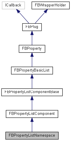

List: Namespace
Definition at line 62 of file fbnamespace.h.
| FBNamespace* operator[] | ( | int | pIndex | ) |
Get the Namespace object at pIndex.
| pIndex | Index of Namespace to get. |
