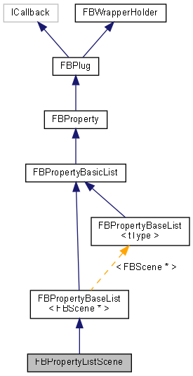

PropertyList: Scene.
Definition at line 237 of file fbscene.h.
