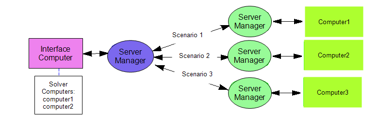

Remote Computing is an innovative method within Autodesk® CFD to run analyses on remote computers on your network. It is a way to temporarily ramp up analysis capability by using (often underutilized) in-house computer resources. Remote Computing is not an ASP model nor is it distributed computing. Alternatively, it is an innovative way to run multiple analyses on multiple computers.
Interface Computer:
The simulation is defined on the interface computer. The CAD model is usually prepared here as well.
Solver Computer:
The simulation is run on the solver computer. Use the Solver Computers dialog (Setup > Simulation drop down menu > Solver Computers) to designate computers on the network as remote solver computers.
Server:
CFDServer.exe is a service that must be running on each Solver computer. This service waits for a call from an interface computer to start an analysis. When a call is received, it provides communication between the two computers.
This service is configured to start automatically on the Interface and Solver computers when the software is installed. It can be stopped, started, and monitored using CFDServerManager.exe, located in the installation directory.

Launch the model from the CAD system to the Interface computer, and set up the simulation as you would a model to be run locally. When ready to run, open the Solve dialog, and select the desired computer from the Solver Computer menu on the Control tab. Click Solve to launch the simulation.
Instead of running on the local computer, the simulation data is sent to the specified Solver Computer. The mesh is generated and the results are calculated. As the scenario runs, graphical results are sent back to the Interface computer for run-time results visualization.
