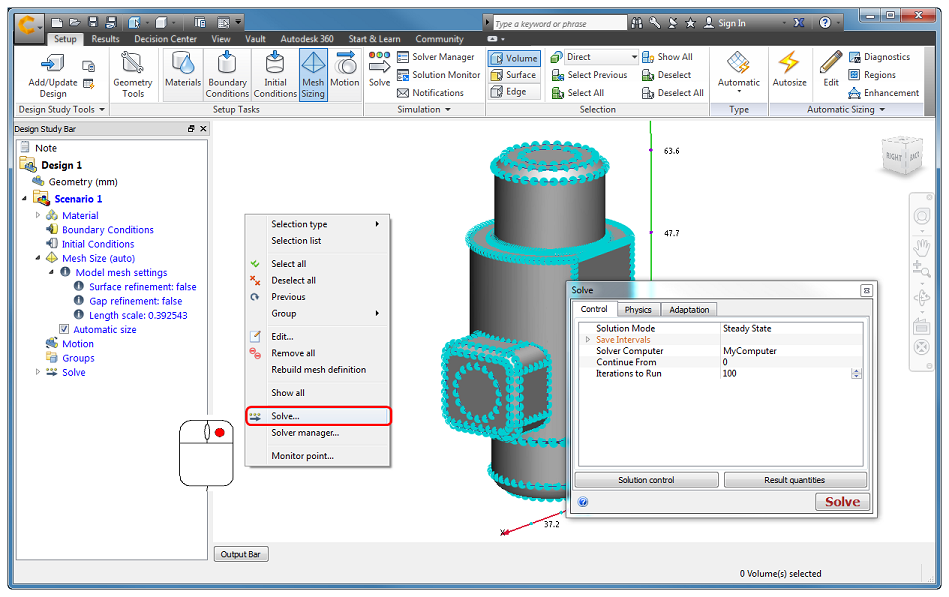

Method 1: Right click off the model, and select Solve

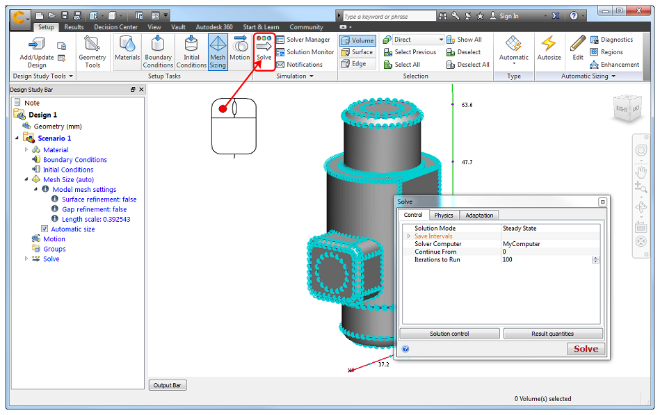

Method 2: Click Setup (tab) > Simulation (panel) > Solve

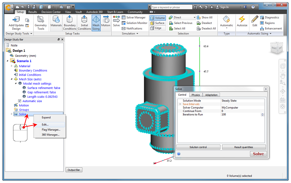

Method 3: In the Design Study bar, right click on Solve, and click Edit...
