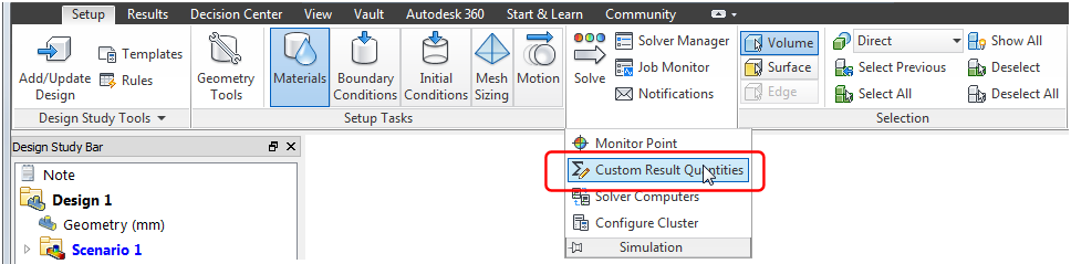

Click Setup > Simulation > Custom Result Quantities to open the dialog.

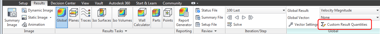

You can also open the dialog when working with results. Click Results > Global > Custom Result Quantities.

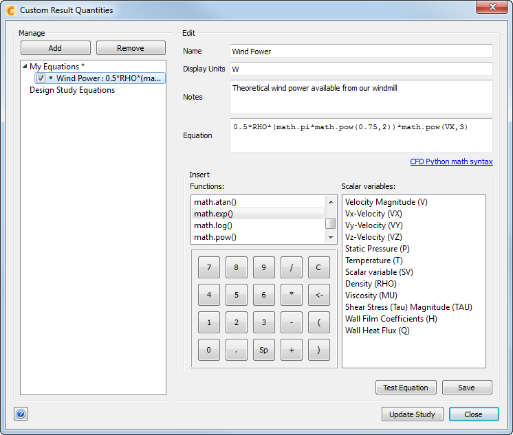

Let's assume we are modeling a windmill with a blade radius of 0.75 meters. We want to create a quantity that tracks the theoretical wind power available to our windmill. Theoretically, this wind power can be expressed as:
where P is the power (W), ρ is the density of air (kg/m3), A is the area (m2) of the circle created by blade rotation, and V is the wind velocity (m/s).
We have input the values into the Custom Result Quantities dialog, as shown in the following image.
Some dialog highlights:
Equation results are non-dimensional. To manually apply units to your quantities, enter appropriate values in Display Units.
Equations adhere to Python syntax.
You can double-click Functions and Scalar variables to add them to the Equation field. You can also key in the values.

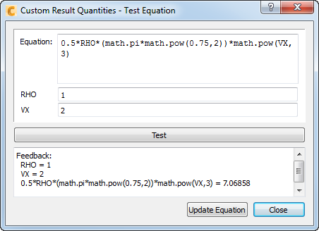

Click Test Equation to open a dialog in which you can verify and modify your equation. If you do modify your equation, click Update Equation to pass the new equation back to the Custom Result Quantities dialog.
Click Save to save the equation to your study.

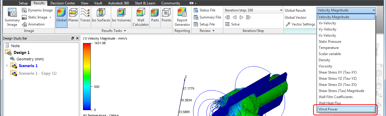

Click Update Study to make the quantity available in your results. For example, after updating our study, we can select Wind Power as a Global Result:
