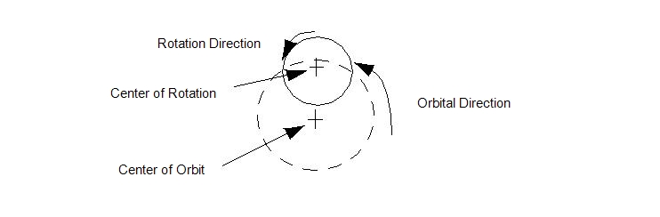

Combined Orbital/Rotation motion is another combination motion mode--the object rotates about its axis of rotation, and also orbits about an axis parallel to its axis of rotation. Rotational motion is described in the Angular Motion section of this chapter.

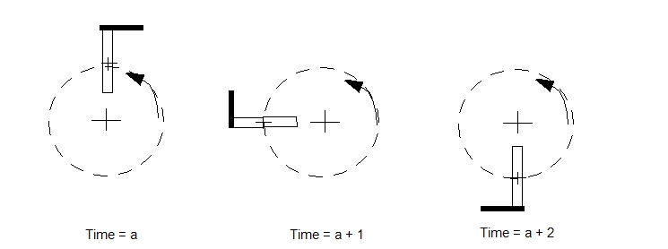

Orbital motion is the circular displacement of an object about an axis. The orientation of an object in pure orbit (with no rotational component) does not change. This is shown below:

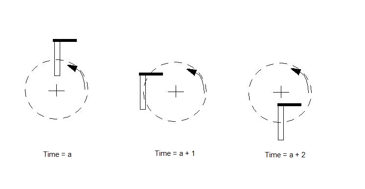

The combined rotation and orbital motion is shown below (in this graphic the rotation and orbital speeds are the same):
The orbital speed is usually slower than the primary rotational speed.
A typical application for Combined Orbital/Rotational motion is a pump shaft with an eccentric orbit (or whirl) component. The shaft rotates about its centerline, but also has an eccentric rotation about an additional axis.
