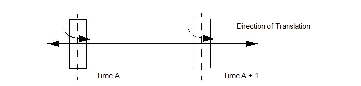

Examples of combined motion include an object sliding along a path and rotating about its center axis. The center of rotation is translating with the object:

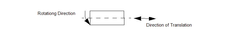

Another example is an oscillating piston whose axis of rotation is its direction of travel. This is a typical configuration found in many flow meters.
