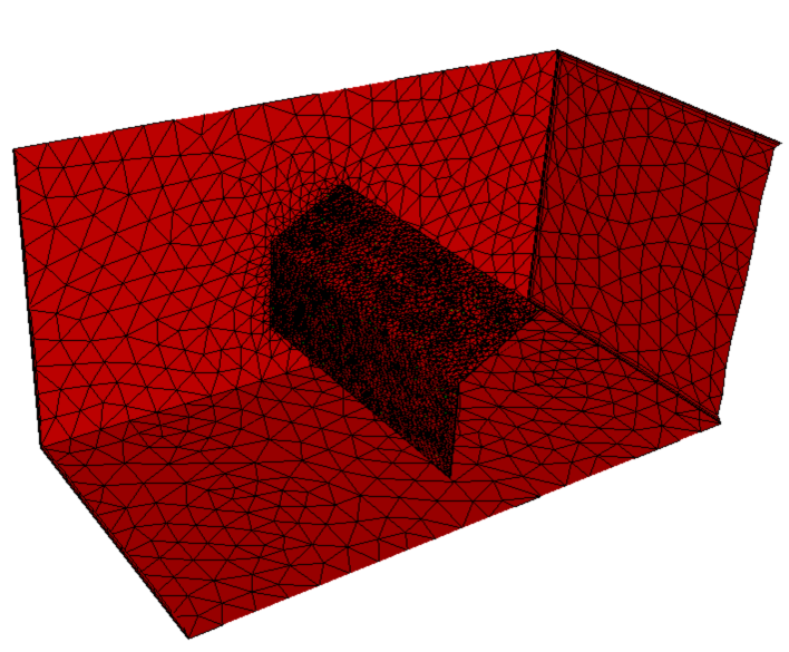

The following model contains a thin-walled obstruction that is modeled as a volume. The element size needed to represent this volume is quite small (because the part is so thin), so the element count is large (about 158,000 elements).

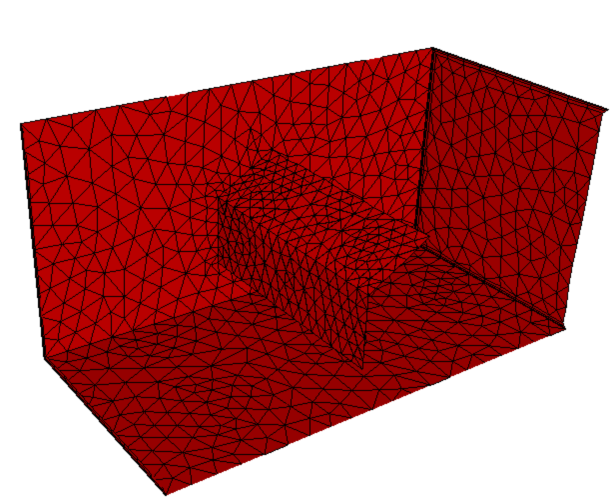

This model, however, uses a Surface Part to represent the thin obstruction. The element size on the surface part is not vastly different from that of the surrounding air, and the overall element count (model size) is considerably smaller (about 38,000 elements):

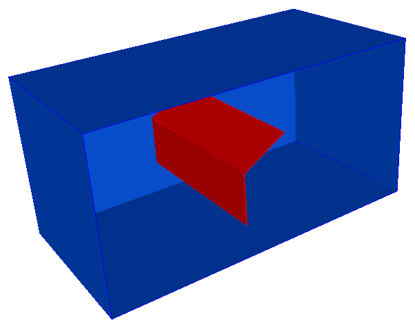

In some situations, it is easier to include a volume within an assembly, and assign one or more surfaces to be Surface Parts. The part is a fluid, and the surface or surfaces are solids which block the flow.
A surface that is part of a volume:
The volume is assigned a fluid material, but because the two front surfaces are assigned a solid material, they are considered to be Surface Parts, and will obstruct the flow:

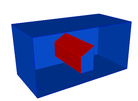

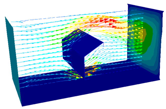

Surface parts are always assigned to surfaces. In many cases, it is practical to construct floating surfaces within the three dimensional model. Some CAD tools allow such surfaces to be separate components in an assembly. Others require that these surfaces just be features within a part. An example of a surface feature or part is shown:
The surface is not part of a closed region, but if a solid material is assigned to it (as described above), it will obstruct the flow:

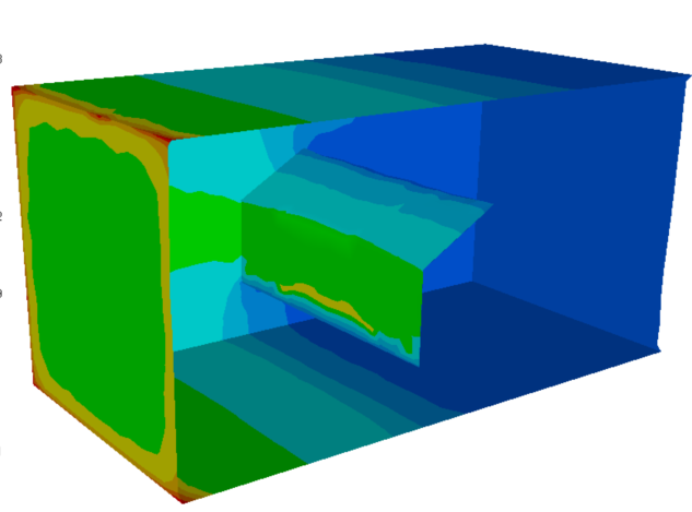

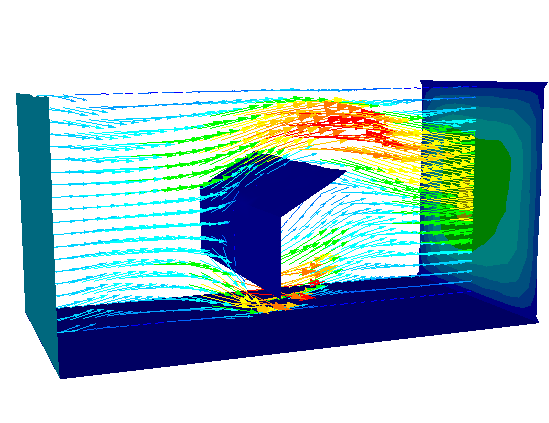

The standard visualization tools in Autodesk® CFD work with Surface Parts. Cutting planes and iso surfaces will display results caused by the presence of Surface Parts. Probe results by hovering the mouse over the area of interest.

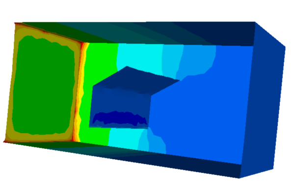

The displayed value of pressure on Surface Parts depends on which side of the Surface Part is viewed. The leading side of a Surface Part will show high pressure, and the wake side will show lower pressure:
When visualizing results, Surface Parts are listed in the Feature Tree under the Materials branch. They are listed separately from volume parts--even those with the same material. Surface Parts can be used as the source surfaces for non-planar cutting surfaces. This is discussed in more detail in the Results Visualization chapter of this manual.
Wall results are assessed on Surface Parts by selecting the appropriate side of the surface. In the example above, selecting the leading side would show a higher wall force than selecting the drag side.
