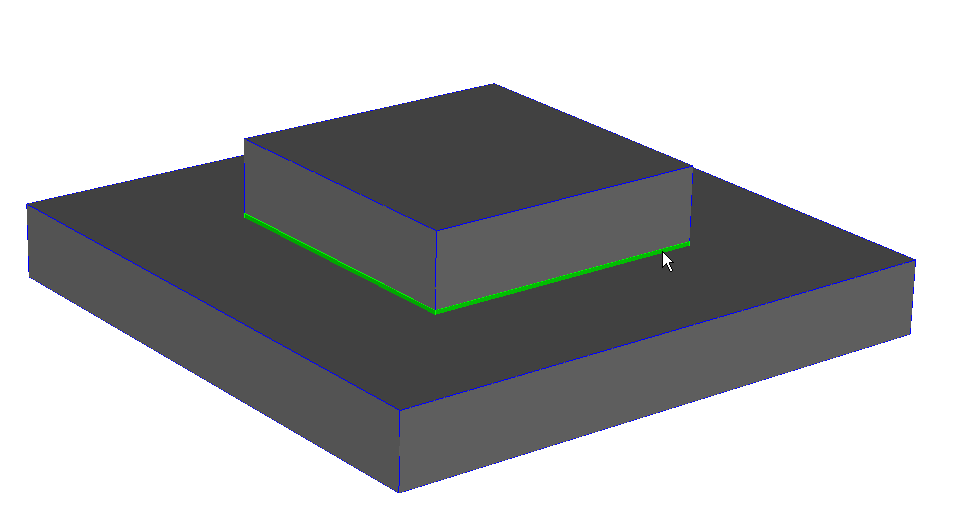

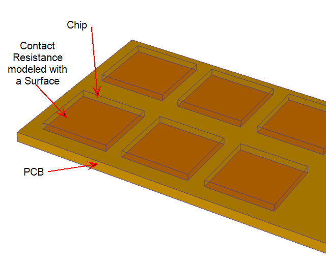

The Contact Resistance material is used to simulate the resistance to heat transfer at the interface of two parts (typically a chip and heat sink or chip and board) due to imperfections and tiny gaps in the mating surfaces in 3D models.
Unlike the other surface part applications, Contact Resistance does not require a thickness. The only required parameter is the Resistance. When a contact resistance is applied between two solids, only the temperature gradient normal to the surface part is considered. In-plane temperature gradients are disregarded.

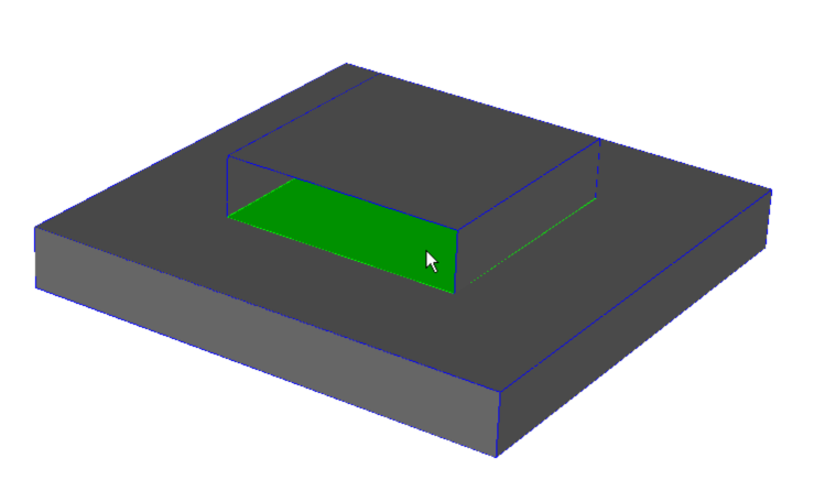

To create a Contact Resistance material, set the Selection Mode to Surface. Open the Material quick edit dialog, set the Type to Contact Resistance. Click Edit, and the Material Editor opens.
Example showing creation of a Contact Resistance material
