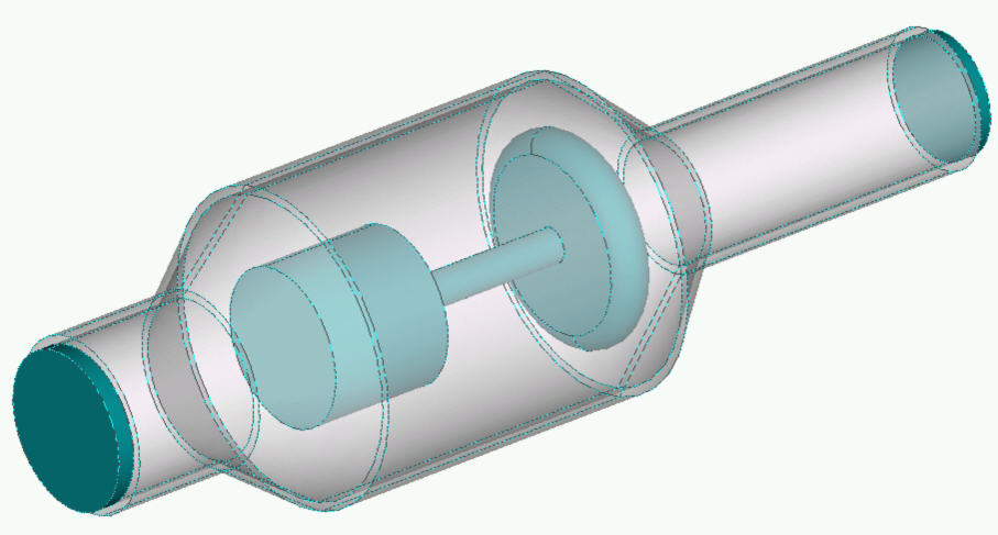

Step 1: Pipe geometry--only the physical solids exist (pipe wall and poppet):

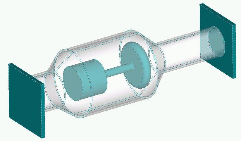

Step 2: Pipe geometry with newly-created volumes at the ends (pipe wall, poppet, and two end caps). The end caps were created by extruding the inner-radius curves of the pipe. This extends the flow volume slightly, but they can be suppressed from meshing if necessary.

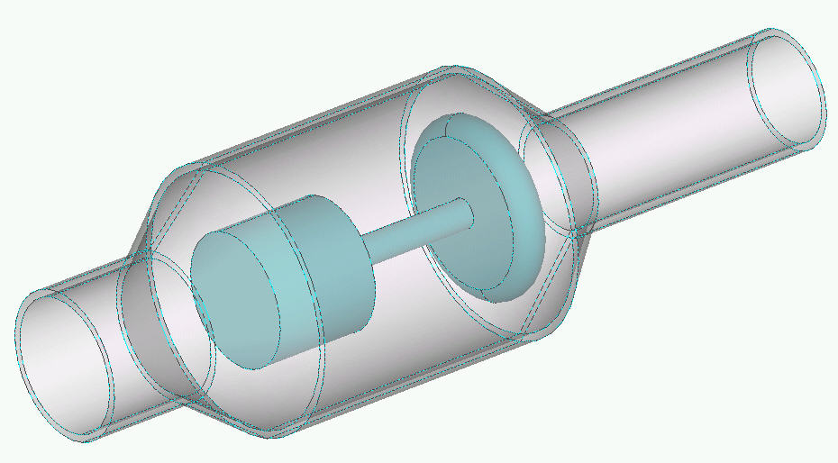

Step 3: Geometry read by Autodesk® CFD--the flow core has been created automatically, and is shown as the highlighted volume. There will now be five parts listed in the Material branch of the Design Study Bar: the pipe wall, the poppet, the two end caps, and the flow volume.

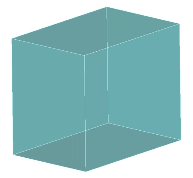

Step 1: An empty box representing the air in an electronics box.
