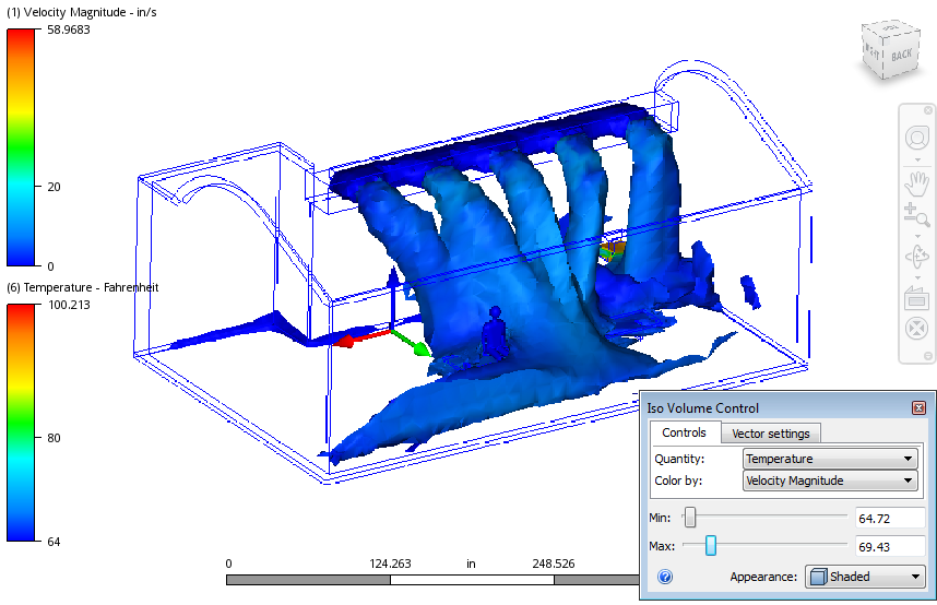

An Iso Volume is the volume of a model that falls within a specified range of a result quantity value. Unlike an Iso Surface which shows everywhere in the model that has a single, specified value, an Iso Volume shows everywhere that falls within a range of that result value.

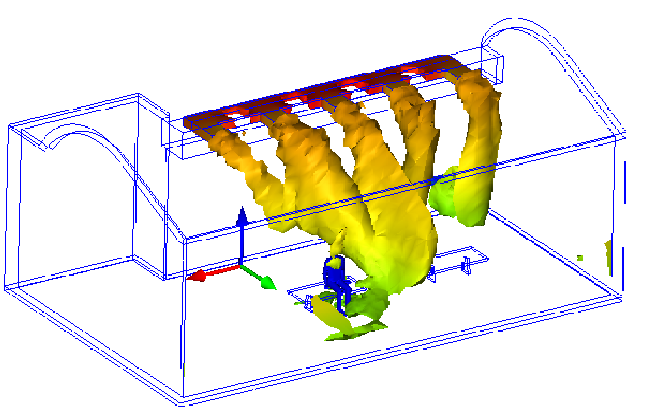

The following shows an velocity magnitude Iso Volume colored by temperature. The shape of the Iso Volume indicates everywhere in the model that falls within a specified range of velocity magnitude. The colors indicate the temperature.

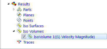

Off-model: Use the Iso Volumes branch of the Design Study bar or the Iso Volumes context panel. This is useful for complex models in which it is easier to work away from geometry.
Click Add on the Iso Volumes context panel.
Alternatively, right click on the Iso Volumes branch of the Design Study bar, and click Add iso volume.
Right click on the desired Iso Volume in the Design Study bar, and click Rename.

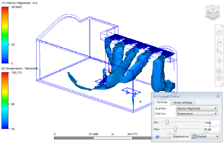

The Quantity is the scalar result that determines the shape of the iso volume. The Color by Result quantity determines the color of the volume. By default, they are the same. Select different scalar results to show two results together. An example is to select temperature as the Quantity, and velocity magnitude as the Color by result. This shows the temperature at all locations in the model that fall within the specified range of velocity magnitude.
To change the range of the Quantity, drag the Min and Max sliders.

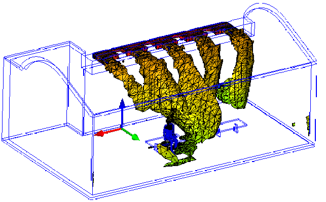

Click More... to make the following changes:
Click Reset or uncheck Filtering to display the entire model.
