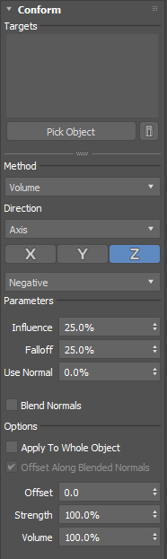

The Conform modifier's rollout provides parameters to select the projection method and set additional controls.
Interface
- Targets
- The
Targets list includes objects that the conform object uses as targets. When objects are added, they are automatically enabled and the conform object moves onto its surface. To disable a target object's visibility in the scene, turn off the check box next to its name.

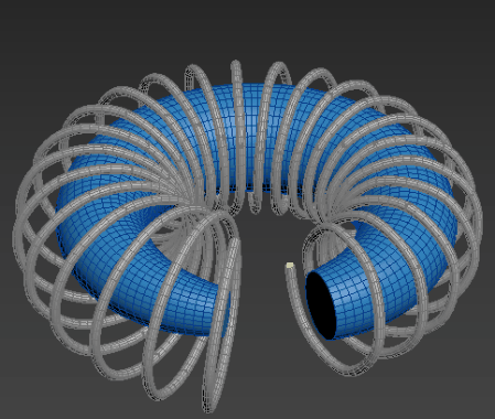

- Volume
- Lets you preserve the conform object's shape after it is projected onto the target mesh(es). The conform object is first projected based on its pivot location, and then vertices are projected onto the target surface. The following example illustrates how both splines and meshes can conform to a surface. For a detailed step-by-step workflow example, see
Conform objects to a surface using the Conform modifier.

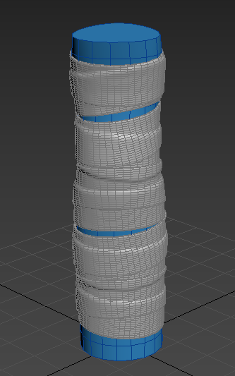

- The following example also uses the
Shrink Wrap projection method to create a wooden handle with fabric bands. For more details and a step-by-step workflow example, see
Create a handle with bands using the Conform modifier.

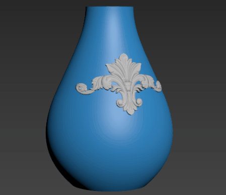

- Axis
- Uses the local X, Y, or Z axis of the conform object as the direction of projection. Click the
X,
Y, or
Z buttons to select an axis. In the following example, the
Y axis is selected, projecting the decal (the conform object) onto the side of the vase (the target object).

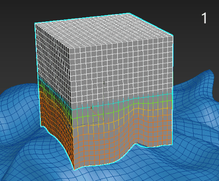

- In the following example, the deformation starts at the bottom of the object because the
Axis Direction is set to Z. As a result, the default Influence value of 25% deforms the bottom quarter of the conform object. The following additional parameters are also set:
1. Influence = 25%; 2. Influence = 50%; 3. Influence = 75%; 4. Influence = 100%
- This option is only available if the Volume method is selected.
- Falloff
- Produces a falloff area outside of the deformation area set by the Influence parameter. The intensity of the deformation gradually decreases across the conform object's falloff area, which can produce smooth transitions. Falloff is represented by a color gradient, in which the colors of the vertices vary depending on the amount of influence the falloff has over them. In the following example, the falloff area is colored orange (most influence), green, and blue (least influence).
1. Influence = 25% and Falloff = 25%; 2. Influence = 50% and Falloff = 25%; 3. Influence = 75% and Falloff = 25%; 4. Influence = 100% and Falloff = 25%
