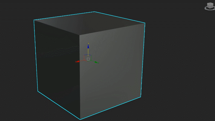

FFD performance |
The following performance improvements have been made to the
FFD Modifiers:
