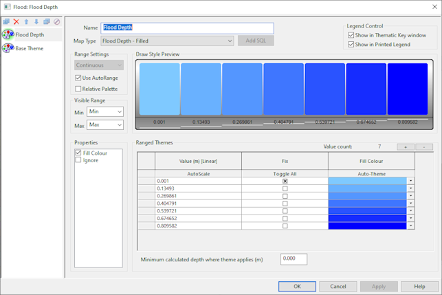

  3. Click on the Edit button of the Theme column for the Flood object layer. The Layer Theme Editor is displayed:
  4. The default Flooding theme is called Flood Depth and is based on flood depth. The default Map Type is Filled but other types are also available (see table below). Fill contours of flood depth values have been auto-themed so the Draw Style Preview shows a graduated set of colours going from light blue for low flood depths to dark blue for high flood depths.
    Note: You cannot create additional Ground Model and Flood sub themes as there is only one parameter to theme (z and flood depth, respectively). However, you can choose between different map types (Filled, Line, Show Layers and Transparent).
  5. Change the name of the Flood Depth theme (Name box) if required and select a different map type in the Map Type dropdown list.
  6. Tip: The provided Flood theme will only be editable if a simulation and a ground model have both been loaded onto the GeoPlan.
  7. Set up your contour parameters following the instructions detailed in the Managing Themes topic and click on OK to commit your changes. See Flood Levels Theme Data Fields table below.

One thing you might want to do is just display the flooded outline, without gradations for flood depth. In this case, simply select one range, with the value set to zero. Give the single range a sensible colour such as dark blue.
Fixed Ranges
You may want your ranges to have fixed values, rather than dividing the entire range of flood depths into equal portions. For instance you may want flood contour 0.5 metres apart.
To do this fix the value of the lowest and highest range. You will have to work out what are sensible values to enter.
For example, setting the lowest range to zero, and the highest range to 5, and then choosing eleven ranges, will give a set of ranges covering half metre intervals.
Alternatively you could define the values for all ranges manually, and fix them all.
