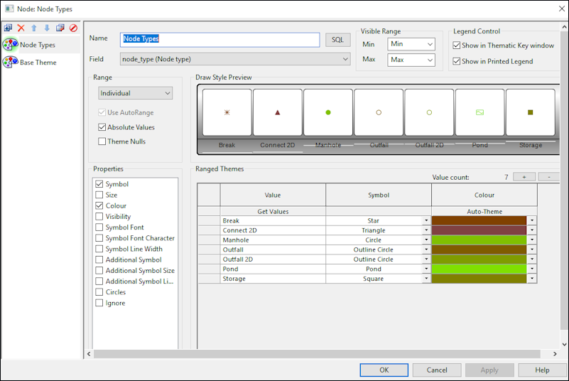

Layer Theme Editor
The Layer Theme Editor is displayed when the Edit button of the Theme column is clicked for a network object type on the GeoPlan Properties - Layers and Themes Page.
This topic describes the Layer Theme Editor, which is the dialog used to set up themes. Refer to the Managing Themes topic for more information on how to create, edit or delete GeoPlan themes.
The Layer Theme Editor allows you to change the display options for themes and contour plots for every network object and ground model on the GeoPlan Window. It consists of:

Use the Display precision dropdown box to select the number of decimal places to be shown when displaying SQL expression results in labels.
Simulation parameters are prefixed with sim. If a second set of results is open for comparison in the same GeoPlan, the second set of simulation parameters are prefixed with sim2.
For example: sim.qnode - sim2.qnode can be used to compare nodal inflow results between two simulations.
You can use SQL expressions that return non-numeric results such as text strings and date types, and then theme on their results. For example, if there are some nodes with a system type of "other" and you use a user defined field, such as user text 1, for providing more information about them, then, if you want to highlight the nodes in the network that have this additional information, you can use the expression:

Range
The most valid range settings for your previous selections are selected by default. You can select the range settings you require if the default ones are not suitable.
Range Settings are:
Continuous. Displays objects differently based on a series of ranges of a parameter. Suitable for parameters with continually variable values, such as depth or flow.
Individual. Displays objects differently based on individual values (rather than ranged values) of a parameter. Suitable for parameters with a small number of discrete values.

Properties
Specifies the theme properties that are shown and customisable in the Ranged Themes grid. Property check boxes that are ticked in the Properties box will have a corresponding column in the Ranged Themes grid.
Select the desired properties for your theme.

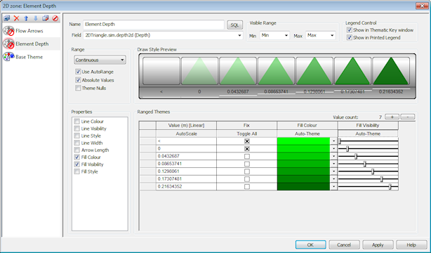

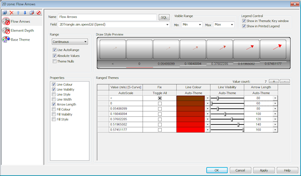

Ranged Themes
  • Plus and minus buttons ( ) - respectively add or remove values within the range; hold the button down to add or remove multiple values. The number of ranges is displayed next to the buttons. When values are added, these are calculated according to the distribution type that has been selected (see below).
  • Value column: Either use the values automatically set up by InfoWorks ICM or fill in the values you need manually.
  • Autoscale button (Unavailable for choice lists such as node type, for example). Click to apply a different type of distribution for the values. Click on the button until the desired distribution is obtained. Use in conjunction with the cumulative frequency histogram displayed in the Draw Style Preview to select a suitable distribution. Available distribution types are:
    • Linear (default)
    • S curve
    • N curve
    • Exponential - (useful if most of the parameter values are in the low end)
    • Log - (useful if most of the parameter values are in the high end)
    For a Direction range setting, the AutoScale function automatically scales the values to provide a complete range; -180 degrees (West) through -90 degrees (South), 0 degrees (East) and 90 degrees (North) to 180 degrees (West again).
  • Fix column - Check this box to fix the value of the range to the current value. When fixed, this value will not change when the value column is scaled (When the Use AutoRange check box in Range is ticked).
    It is possible to fix/unfix all the values at once, by using the Toggle All button (see below).
    • Toggle All - click this button to turn on/ off the fix for all the values of the range at once.
    Note that the Fix column is not available for Direction ranges.
  • Available attributes - these are listed in the sections below. Use the check boxes and the dropdown boxes to set up the sub theme.
    • Auto-Theme button - this button is very similar to the Autoscale button for the Value column. It is particularly useful if you have added intermediate values by using the Plus button at the top right-hand corner of the Ranged Themes section ( buttons). Set a value for the top and bottom property settings in the grid and then click the Auto-Theme button so that the software interpolate between the low and high values to create a graduated distribution. For properties relating to colour, clicking again on this button cycles through different ways of traversing the colour space between the high and low value.

Point / Node theme attributes
Attribute
Description
Symbol
Check the box to use a symbol other than the default setting (circle).
Select the desired symbol for each value in the corresponding dropdown list.
Symbol size
Check the box to use a symbol size other than the default setting (60).
Select the desired size for each value in the corresponding dropdown list.
Symbol colour
Check the box to use a symbol colour other than the default setting (black).
Select the desired colour for each value in the corresponding dropdown list.
Symbol visibility (%)
Check the box to use a visibility other than the default one (100%) for the symbol.
Use the slider to control the symbol visibility for each value (Slider at the left end indicates 0% visibility whilst slider at the right end means 100% visibility).
Circles
Check the box to use circles in the theme.
Select the desired number of concentric circles for each value in the corresponding dropdown list.
You can use the Circles attribute to indicate flooding at a node on the GeoPlan Window during replays of a simulation.
Symbol font
Check the box to use a font other than the default one (Ariel) for the character symbols.
Select the desired font for each value from the dropdown list in the Choose Symbol dialog.
Symbol font character
Check the box to use symbol characters in the theme.
Select the desired character for each value from the chart in the Choose Symbol dialog.
Note: When specifying Symbol Font Characters for point objects, to prevent the 'normal' symbol being drawn at the same time as the Symbol Font Character, ensure that the Symbol box is checked, and that the symbol value is set to None.
Tip: The Auto-Theme button (see Sub Theme Editor Pane section), which is available for most of the attributes, interpolates between set low and high values for the range and generates graduated intermediate values for the values in-between.
Line /Link theme attributes
Attribute
Description
Symbol
Check the box to use a symbol other than the default setting (None).
Symbol size
Symbol colour
Symbol font
Line Colour
Check the box to use a line colour other than the default setting (black).
Line Visibility
Check the box to use a visibility other than the default one (100%) for the line.
Use the slider to control the symbol visibility for each value.
Line Style
Check the box to use a line style other than the default setting (solid).
Select the desired style for each value in the corresponding dropdown list.
Line Width
Check the box to use a line width other than the default setting (1).
Arrows
Check the box to use arrows in the theme.
Select the desired number of arrows for each value in the corresponding dropdown list.
Arrow Style
To be used in conjunction with the Arrow property.
Check the box to use arrow styles in the theme.
Select the desired style (-->-- or <--->) for each value in the corresponding dropdown list.
Tip: Note that end arrows always point outwards irrespective of the sign on the arrows count. Also, when multiple end arrows are used, the heads work backwards from the line end.

2D zones have two special themes that are provided by default:
Note: Both themes are disabled by default. This is identifiable by the greyed out palette with the disabled icon () overlay in front of their name in the Sub Theme Manager Pane. To enable these themes, select them in the Sub Theme Manager Pane and click on the Enable / Disable button () on the toolbar.
  • Flow arrows or 2D arrows. This theme uses arrows with varying lengths as indicators of the velocity in a mesh element (The field mapped is 2DTriangle.sim.speed2d - speed2d) during replays of a simulation. Arrow length, line colour and visibility have been auto-themed, i.e. lowest and highest values have been set and intermediate values have been interpolated.
  • Depth or 2D triangles - this theme uses the fill colour and visibility of 2D triangles as indicators of flood depth within the triangles (The field mapped is 2DTriangle.sim.depth2d - depth2d) during replays of a simulation. Fill colour and visibility have been auto-themed.
2D Zone attributes
For 2D Zones with results, the following attributes can be used in a theme to provide, for example, arrows scaled by speed and oriented by direction.
Attribute
Description
Arrow Length
Check the box to use an arrow length other than the default setting (100).
Select the desired length for each value from the corresponding dropdown list.
Arrow Angle
Check the box to use an angle for the arrow other than the default setting (0).
Use the slider to control the arrow angle for each value.
Tip: When using this property with a Direction range setting, a larger the value count will provide a higher degree of accuracy when Autoscaled.
