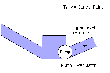

The following example shows the RTC for controlling the operation of a pump according to the volume in a chamber, by using a table to define the relationship between chamber level and volume.
Under this example, a pump is operated depending on the volume at a node.
The relationship between the height above datum and the volume at the node is defined in a Table in the RTC.

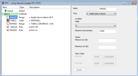

RANGE 1
Range type: Z - Height above datum
Location node: D
Minimum:
Maximum:
TRUE if height above datum is between - / + infinity

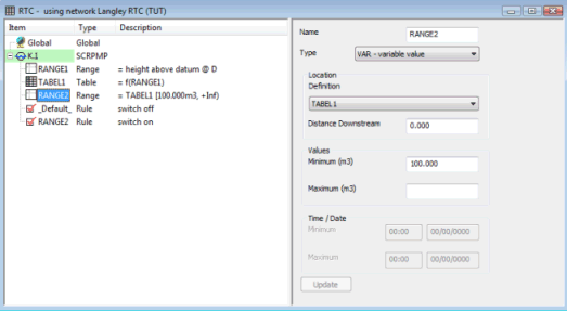

RANGE 2
Range type: Variable
Location Definition: TABLE 1
Minimum: 100m3
Maximum:
TRUE if volume is greater than or equal to 100 m3

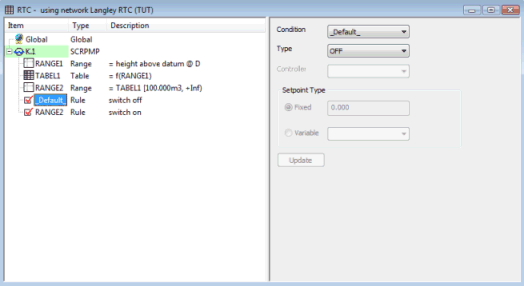

RULE 1
Condition: _default_
Rule type: OFF
DEFAULT status of pump is OFF

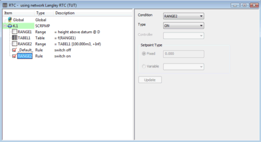

RULE 2
Condition: RANGE 2Rule type: ON
Switch pump ON if RANGE 2 is TRUE
  1. Range 1: Defines node D as the control point

  3. Range 2: Operates the pump according to the volume at node D
  4. Rule 1: Pump is switched OFF by default
  5. Rule 2: Pump is switched ON when volume at node D is greater than or equal to 100 m3
