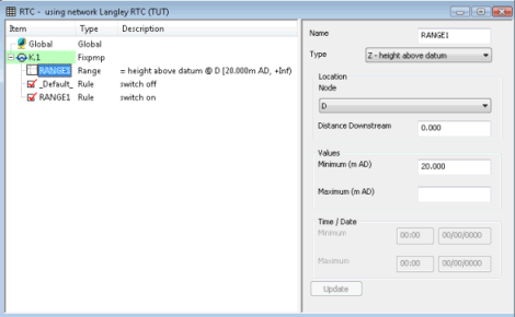

RTC Window Editor - Range Pane
Ranges provide a logical output which is TRUE if the measured variable is within the defined range and FALSE if it is outside the defined range. Variables can be measured at any point in the system; they do not have to be local to a regulator.
For an example of the use of a Range see RTC Range Example.
The Range pane contains the following fields:

Range type
The following range types are available:
